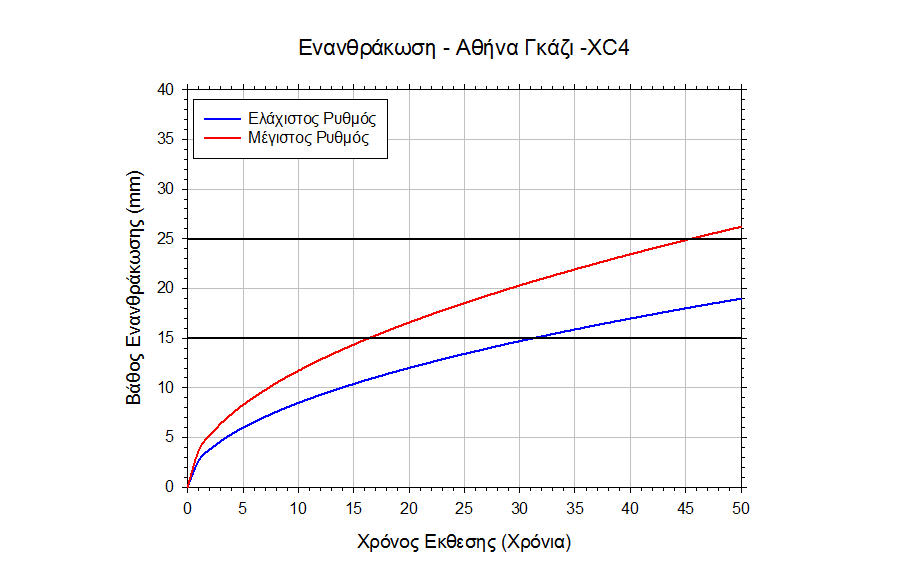

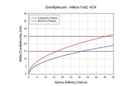

Ροδοπουλος Δημοσιεύτηκε January 19, 2013 at 04:01 μμ Συγγραφέας Δημοσιεύτηκε January 19, 2013 at 04:01 μμ (edited) Έχουμε ξεκινήσει εδώ και κάποιους μήνες να φτιάξουμε μια βάση δεδομένων με ρυθμούς ενανθράκωσης και χλωριόντων για διαφορετικές περιοχές τις Ελλάδος. Η Βιβλιογραφία που χρησιμοποιούμε (μοντέλα) για την ενανθράκωση είναι ACI Committee 365. 1R-42: Service-Life Prediction-State of the Art report, 2000. Durability of Concrete Structures-Investigation, repair, protection, Ed. by G. Mays, E&EN Spon, London,1992. CEB-FIP: Model Code 1990, T. Thelford, London, 1993. CEB-FIP: Durable of Concrete Structures, Design Guide, T. Thelford, London, 1992. Durability Design of Concrete Structures- RILEM Report 14:(Ed. A. Sarja and E. Vesikari), Spon, London, 1996. FIB (CEB-FIP), Bulletin 34 – Model Code for Service Life Design, fib, Lausanne, Switzerland, 2006. Papadakis, V.G., Vayenas, C.G., and Fardis, M.N., 1991, “Experimental Investigation and Mathematical Modeling of the Concrete Carbonation Problem,” Chemical Engineering Science, Vol. 46, No. 5/6, pp. 1333-1338. Clifton, J.R., 1993, “Predicting the Service Life of Concrete,” ACI Materials Journal, Vol. 90, No. 6, pp. 611-617. Tuutti, K., Corrosion of steel in concrete. CBI research 4:82 CBI, Stockholm, Sweden 1982. Liang, M. T., Qu, W-J., Liao, Y.S., A study of carbonation in concrete structures at existing cracks, Journ. Chinese Inst. of Eng. Vol 23, No 2, pp 143-153, 2000. Ali, A., Dunster), A., Durability of reinforced concrete -effects of concrete composition and curing on carbonation under different exposue conditions. BRE-report, Garston UK 1998. Swedish Cement and Concrete Research Institute, Carbon dioxide uptake during concrete life cycle– State of the art, CBI Report 2:2005 Fukushima, T., Theoretical investigation on the influence of various factors on carbonation of concrete, Building research Institute (Japan), BRI Research Paper No 127 (ISSN 0453-4972), Japan, 1988. Gehlen C.: Probabilistische Lebensdauerberechnung von Stahlbetonbauwerken Zuverlässigkeitsbetrachtungen zur wirksamen Vermeidung von Bewehrungskorrosion, Thesis, RWTH-Aachen, D82 (Diss.RWTH+Aachen), Heft 510 der Schriftenreihe desDAfStb, 2000 Θα προσπαθήσω να βάζω κάποια αποτελέσματα Παραδοχές Παραδείγματος Περιοχή = Αθήνα/Γκάζι Αστική (Μη Παραθαλάσια απόσταση απο την θάλλασα >1600 μέτρα) Εξωτερική Επιφάνεια Εκτεθειμένη σε Βροχή - XC4 ΠΑΧΟΣ ΕΠΙΚΑΛΥΨΗΣ = 20mm ΕΠΟΚΛΙΣΗ ΠΑΧΟΥΣ ΕΠΙΚΑΛΥΨΗΣ = ±5mm ΗΜΕΡΕΣ ΔΙΑΒΡΟΧΗΣ > 2mm = 43 Κατηγορία Σκυροδέματος = C20/25 Υπαρξη Ρωγμών = 0 ΠΟΙΟΤΗΤΑ ΕΠΙΦΑΝΕΙΑΣ ΣΚΥΡΟΔΕΜΑΤΟΣ = καλη ΜΕΣΗ ΘΕΡΜΟΚΡΑΣΙΑ KATA THN ΣΚΥΡΟΔΕΤΗΣΗ = 25 ΧΡΟΝΙΚΉ ΔΙΑΡΚΕΙΑ ΩΡΙΜΑΝΣΗΣ ΣΤΟ ΚΑΛΟΥΠΙ = 7 ημέρες ΤΥΠΟΣ ΕΡΓΟΥ = Κτηριακό ΤΥΠΟΣ ΕΞΩΤΕΡΙΚΗΣ ΕΠΙΦΑΝΕΙΑΣ = Εμφανες Σκυρόδεμα ΕΠΙΛEΞΤΕ ΩΦΕΛΙΜΗ ΖΩΗ Τ ΣΕ ΧΡΟΝΙΑ =50 Εαν έχετε κάποια συγκεκριμένη πρόταση ή κάποια αποτελέσματα απο υφιστάμενα μπορούμε να το τρέξουμε (θα μας βοηθήσει και στην στατιστική μας επεξεργασίας). Το μόνο που χρειάζεται να κάνετε είναι να μας δώσετε τις παραδοχές. Edited January 19, 2013 at 04:08 μμ by Ροδοπουλος
kostassid Δημοσιεύτηκε January 19, 2013 at 04:22 μμ Δημοσιεύτηκε January 19, 2013 at 04:22 μμ 2 Παράγοντες: 1) Πως γνωρίζουμε τις συγκεντρώσεις ρύπων ανά περιοχή; Το ΥΠΕΚΑ μετράει σε συγκεκριμένους σταθμούς. 2) Υπαρξη ρωγμών; υπάρχουν ρωγμές οι οποιες δεν φαίνονται με γυμνό μάτι. Τι κάνουμε τοτε; Παίζει ρόλο και η σχετική ατμοσφαιρική υγρασία σε συνδυασμό με την υγρασία του σκυροδέματος. (μεγαλα και μικρά ποσοστά υγρασίας δεν εντείνουν το φαινόμενο της ενανθράκωσης ίσως και να το εμποδίζουν, μεσαίας τάξης υγρασία το βοηθάει να εξελίσσεται)
Ροδοπουλος Δημοσιεύτηκε January 19, 2013 at 04:41 μμ Συγγραφέας Δημοσιεύτηκε January 19, 2013 at 04:41 μμ (edited) Εχουμε τις εξής κατηγορίες για τους ρύπους Αστική (Μη Παραθαλάσια απόσταση απο την θάλλασα >1600 μέτρα) Αστική (Παραθαλάσια απόσταση απο την θάλλασα 1200-1600 μέτρα) Αστική (Παραθαλάσια απόσταση απο την θάλλασα 800-1200 μέτρα) Αστική (Παραθαλάσια απόσταση απο την θάλλασα 400-800 μέτρα) Αστική (Παραθαλάσια απόσταση απο την θάλλασα 200-400 μέτρα) Αστική (Παραθαλάσια απόσταση απο την θάλλασα 50-200 μέτρα) Ημι-Αστική (Μη Παραθαλάσια απόσταση απο την θάλλασα >1600 μέτρα) Ημι-Αστική (Παραθαλάσια απόσταση απο την θάλλασα 1200-1600 μέτρα) Ημι-Αστική (Παραθαλάσια απόσταση απο την θάλλασα 800-1200 μέτρα) Ημι-Αστική (Παραθαλάσια απόσταση απο την θάλλασα 400-800 μέτρα) Ημι-Αστική (Παραθαλάσια απόσταση απο την θάλλασα 200-400 μέτρα) Ημι-Αστική (Παραθαλάσια απόσταση απο την θάλλασα 50-200 μέτρα) Αγροτική (Μη Παραθαλάσια απόσταση απο την θάλλασα >1600 μέτρα) Αγροτική (Παραθαλάσια απόσταση απο την θάλλασα 1200-1600 μέτρα) Αγροτική (Παραθαλάσια απόσταση απο την θάλλασα 800-1200 μέτρα) Αγροτική (Παραθαλάσια απόσταση απο την θάλλασα 400-800 μέτρα) Αγροτική (Παραθαλάσια απόσταση απο την θάλλασα 200-400 μέτρα) Αγροτική (Παραθαλάσια απόσταση απο την θάλλασα 50-200 μέτρα) Υπάρχει βάση δεδομένων για την σχετική υγρασία, τις ημέρες διαβροχής (>2mm) και η ηλιοφάνεια (χρόνος στεγνώματος των πόρων) Για τις ρωγμές πάμε βάση κανονισμού W=0, W=0.1, W=0.2, W=0.3 (εαν θεωρείς οτι είναι μη ορατές βάλε W=0.1. Edited January 19, 2013 at 04:45 μμ by Ροδοπουλος
