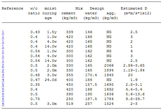

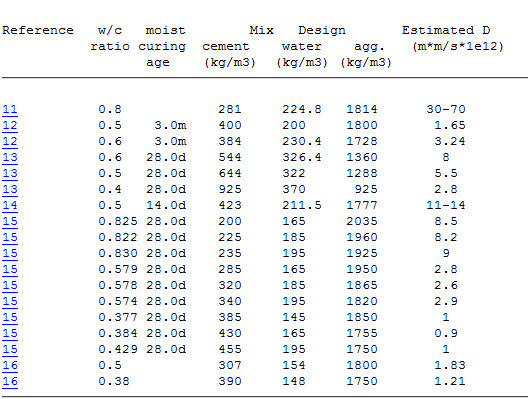

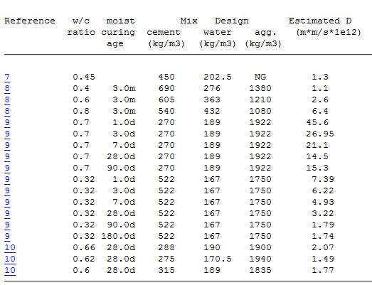

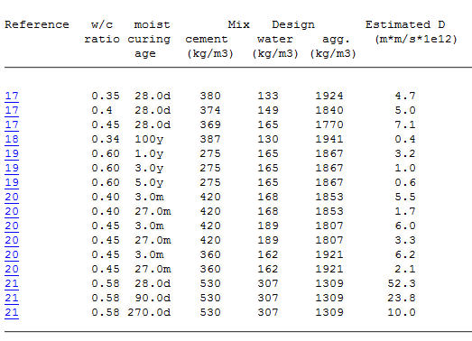

Ροδοπουλος Δημοσιεύτηκε December 23, 2010 at 09:22 πμ Συγγραφέας Δημοσιεύτηκε December 23, 2010 at 09:22 πμ Βαζω τιμές απο βάση δεδομένων πιστευω να τις βρείτε χρήσιμες.

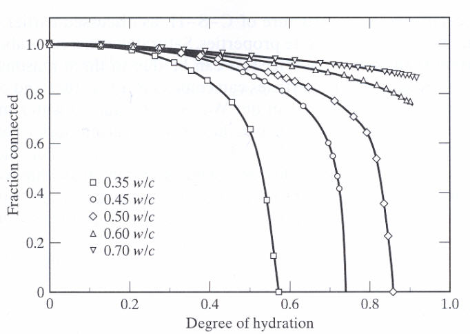

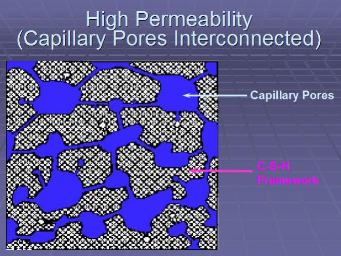

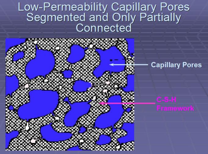

Ροδοπουλος Δημοσιεύτηκε January 3, 2011 at 11:41 πμ Συγγραφέας Δημοσιεύτηκε January 3, 2011 at 11:41 πμ 1. Concrete strength, durability, and volume stability is greatly influenced by voids in the hydrated cement paste 2. Two types of voids are formed in hydrated cement paste Gel pores Capillary pores 3. Concrete also commonly contains entrained air and entrapped air Gel Pores Space between layers in C-S-H with thickness between 0.5 and 2.5 nm Includes interlayer spaces, micropores, and small isolated capillary pores Can contribute 28% of paste porosity Little impact on strength and permeability Can influence shrinkage and creep Capillary Voids Depend on initial separation of cement particles, which is controlled by the w/c It is estimated that 1 cm3 of anhydrous portland cement requires 2 cm3 of space to accommodate the hydration products Space not taken up by cement or hydration products is capillary porosity On the order of 10 to 50 nm, although larger for higher w/c (3 to 5 mm) Larger voids affect strength and permeability, whereas smaller voids impact shrinkage
