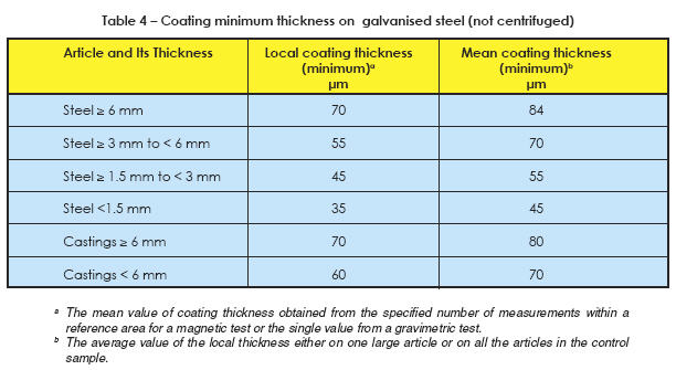

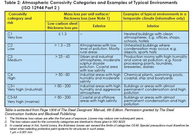

Ροδοπουλος Δημοσιεύτηκε October 12, 2011 at 10:49 πμ Συγγραφέας Δημοσιεύτηκε October 12, 2011 at 10:49 πμ Atmospheric Corrosivity Categories and Examples of Typical Environments (ISO 12944 Part 2 ) Galvanising Thickness ISO 1461:1999

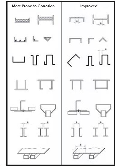

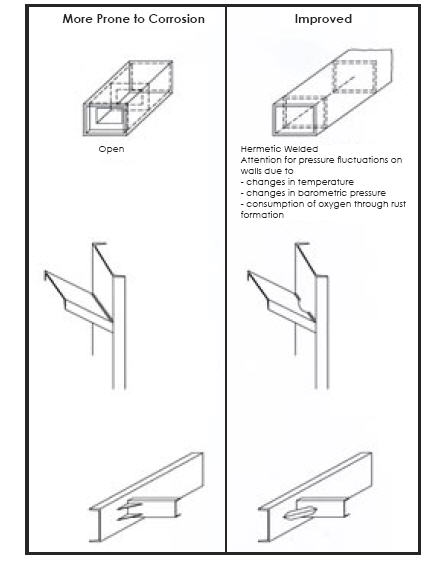

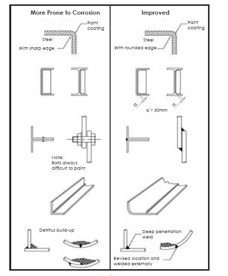

Ροδοπουλος Δημοσιεύτηκε October 12, 2011 at 10:55 πμ Συγγραφέας Δημοσιεύτηκε October 12, 2011 at 10:55 πμ Design to avoid formation of humid and dusty zones. Provide drainage holes and openings with a > 30mm to drain moisture and dirt. φωτό 1 Design to avoid entrapment of moisture and dirt and corrosive elements on or between parts of structures. Use hermetic sealing for hollow sections, provide drainage holes between inclined members and stiffeners. φωτό 2 Design with rounded angles to avoid corrosion. Edges and corners are corrosion sensitive points even when protected by coatings. φωτό 3
