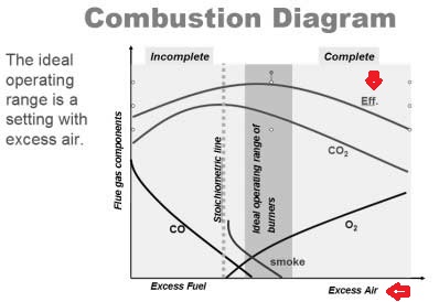

mixmentzos Δημοσιεύτηκε Απρίλιος 13 , 2013 Δημοσιεύτηκε Απρίλιος 13 , 2013 (edited) To διάγραμμα που επισυνάπτω σχετικά με το λ νομίζω σου απαντάει Για περιορισμό των ΝΟx σε παραπέμπω στο παρακάτω "Oxides of Nitrogen (NOX) Optional Measurement Measurement of NOX and other pollutants are required in some jurisdictions on certain types of equipment. As a safety factor to assure complete combustion, appliances are fired with excess air. One of the factors influencing NOX formation in a furnace or boiler is the excess air level. High excess air levels (>45%) may result in increased NOX formation because the excess nitrogen and oxygen in the combustion air entering the flame will combine to form thermal NOX. Low excess air firing involves limiting the amount of excess air that is entering the combustion process in order to limit the amount of extra nitrogen and oxygen that enter the flame. This is accomplished through burner design and can be optimized through the use of oxygen trim controls on commercial applications. Low excess air firing is used on most appliances and generally results in overall NOX reductions of 5-10% when firing natural gas. High flame temperatures and intimate air/fuel mixing are essential for low CO emissions. Some NOX control technologies used on residential, industrial and commercial burners reduce NOX levels by lowering flame temperatures through modification of air/fuel mixing patterns, or creation of intentional flame impingement. The lower flame temperature and decreased mixing intensity can result in higher CO levels." Από COMBUSSTTIION ANALLYSSIISS An Essential Reference forThe Advanced Technician by James L. Bergmann HVACR Technical Specialist Edited Απρίλιος 13 , 2013 by mixmentzos 2
